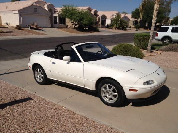

It was a 1994 R-Package with 103k miles on the clock, kept mostly in Colorado driven by the guys mom, only during summers (no rust) and it was even serviced by Flyin' Miata regularly. Not even a hint of lifter tick, no accidents and it drove awesome on the test drive. The only thing not stock were the shocks (no "R" bilsteins) but they were getting replaced anyways. While we were there, his phone was ringing off the hook with people offering almost $1000 over asking price, but we were lucky he was a stand up guy and fellow car enthusiast and he said if we wanted it for the $3500 full asking price, it was ours. We agreed and we were back the next day with cash and took it home. That's where the fun starts.
