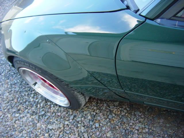

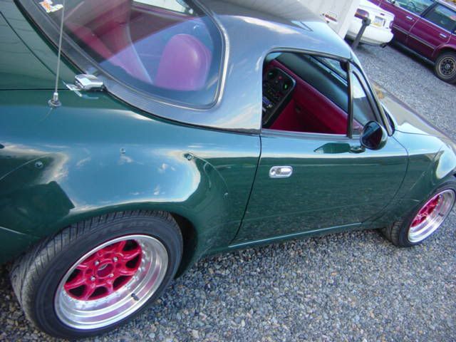

those are the best flares ever.
although molded really cleans up the lines, I think they look great with the visible rivets.
2,723 Posts
The fit looks great- it really follows the contours of the boy well, even all the creases etc.
I like rivets more than molded. Molded is a bad idea anyways- when the body flexes the bondo will crack eventually. And the metal will expand at different rate than the fiberglass, etc,etc.
12,259 Posts
Not all plastic body filler is made by Bondo® and not all plastic body filler is poor quality. It's just another tool in the body man's tool chest. Like any project you've got to have the right tool for the job and know how to properly use it to achieve satisfactory results. I like the exposed pop rivets on this car. Fiberglass and metal and plastic body filler do have different coefficients of thermal expansion. It's possible to mold steel fender flares to steel body panels using lead filler and get good results. I think that with fiberglass flares molded to metal panels the seam will always be the weakest part. It might look great for years without issue. But a poor job will show up within a very short time.
