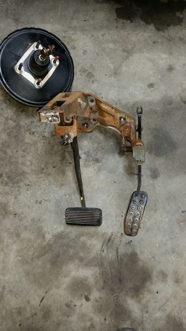

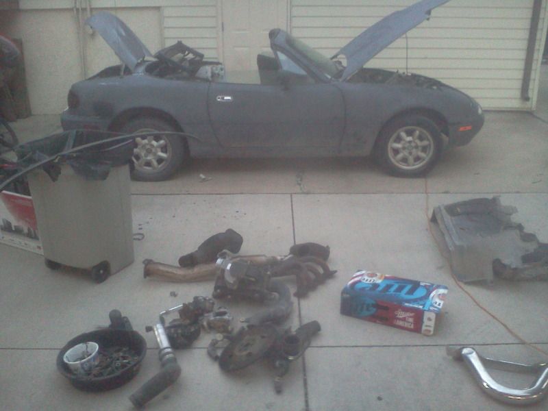

Starting the tear down, pulling parts out of the car.

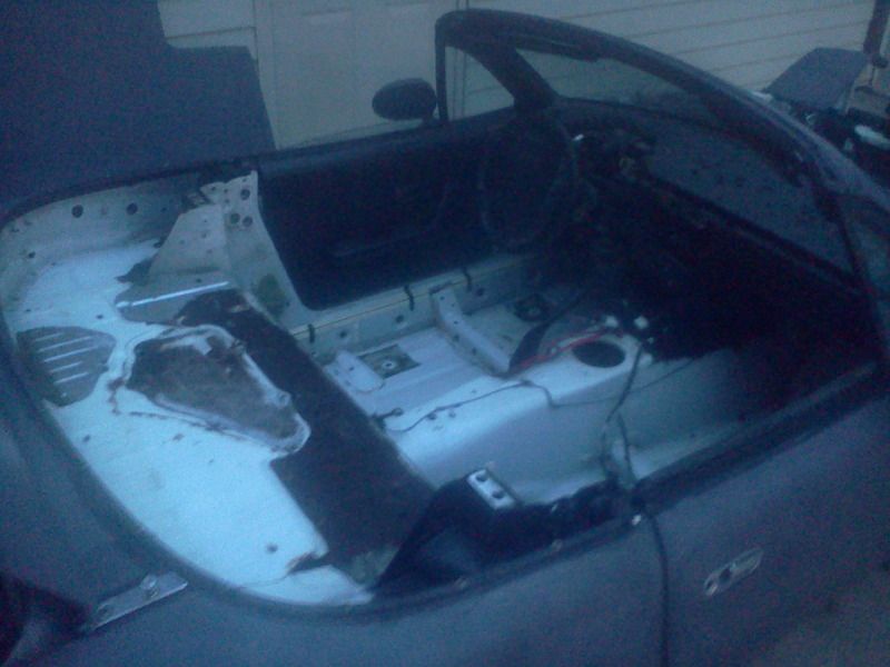

The interior, what was left of it was in pretty rough shape. The tombstone was in about 6 pieces, the dash was cracked in a couple of places and the carpet was all torn up.
This is all I have of the initial tear down.

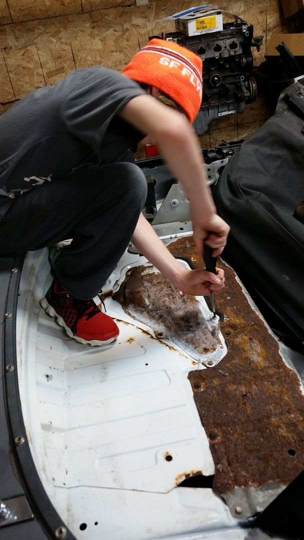

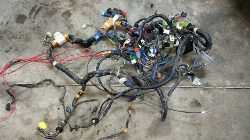

I have been working on the car with my wife and kids, we finished the tear down and pulled the wiring harness out of the car.
Before paint.
The wiring harness was hacked up in a few places, so it was pulled in favor of the new one in the parts car.
