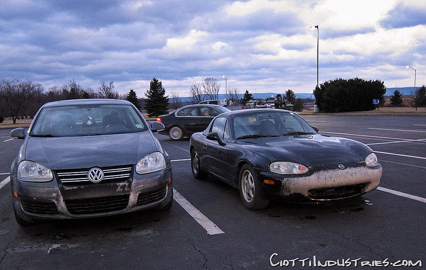

The car was clear on the opposite side of PA from NJ, so it took 6 hours to get there through a bunch of snow blowing down from the lakes...
Pretty sights but I wasn't looking forward to driving back through it in a 2,000 pound car that I wasn't familiar with.
We made it just fine and within minutes of seeing the car I knew I had to have it, decent set-up of mods for STR, hard top, etc... A quick test drive sealed the deal... Done Mine!
Joe had kept all of the stock parts so we loaded my girlfriend's Jetta up pretty much top to bottom with dirty parts and 6UL's, and Joe told us to get atta ere!
I was frankly blown away at how capable the car was with the stock wheels and all seasons in the snow and slush, the fact that I'd been driving the Cobra in the snow for the past however many years may have had something to do with that BUT at no point did I feel sketched out in the snow with the Miata. It was snowing so hard that the car actually picked up a bit of a milk mustache...
Luckily as it got dark the snow let up and driving into the darkness I realized that I was already falling in love with this little car.
