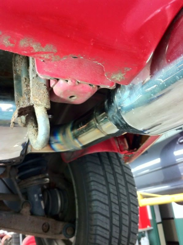

Issues 1: Exhaust tip was rubbing against the factory tow hook support and rear bumper, I heated up the pipe at the curve post rear muffler, and bent it outward slightly.

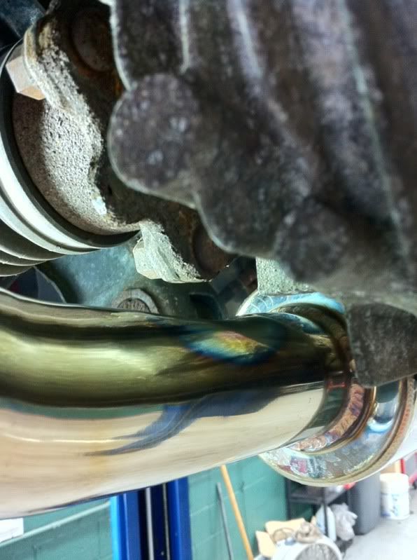

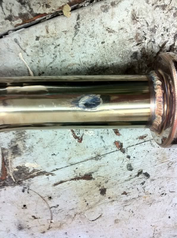

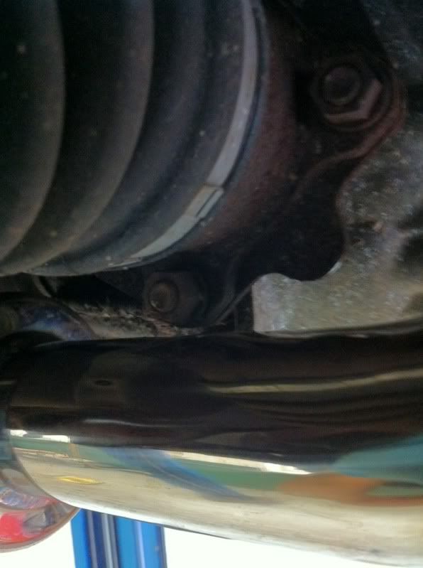

Issue 2: Upon acceleration the exhaust would rub at the left rear axle drive flange, I first loosened the bolts and adjusted the system down as far as I could. I may have been able to do just this, but to be sure I heated the pipe around where it was rubbing and gently squeezed with the vice to crush the area a little flatter.
Clearance Before
Rubbed Spot
Clearance After
Clearance Before
Rubbed Spot
Clearance After
