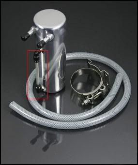

hey guys, jus wondering how many run oil catch cans for their miata and if they use an open or closed system.
also.. when attaching your hoses, pcv valve -> catch can, breather -> catch can. is that all thats involved in a closed system ?
what is this little tube thing on the side of the catch can suppose to do ? (redbox_

the little thing on the side is so you can see how much oil you have in the can.
ah i see, thanks man.
