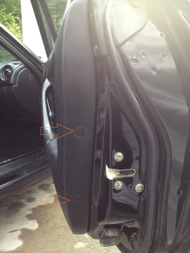

here is your nb door panel and location of screws/clips/etc. you need to remove, the top left pop rivet you need to pry out the center part
and theese two as well, theese two you push in the middle rather than pry out the middle

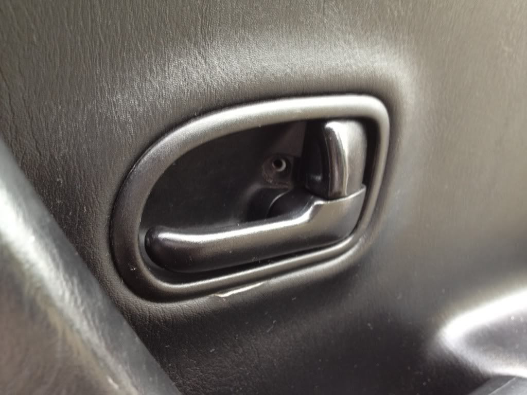

heres some pictures of the locations of the hidden screws

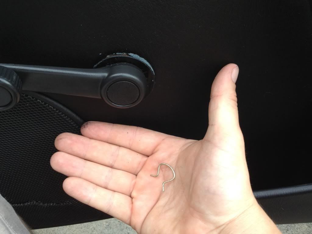

put a screw driver behind the window arm oppsoite side of the handle and pry the clip out
this is what the clip looks like behind there
after removing all theese there is plastic pop rivets securing the panel to the door, i found the best way to not break them is too locate them and pull quickly on the edge of the door, after youve gotten the panel loose lift the panel straight up

NA6 has 1 screw in the door handle and 3 in the door pull, so a bit easier than NB it looks like
