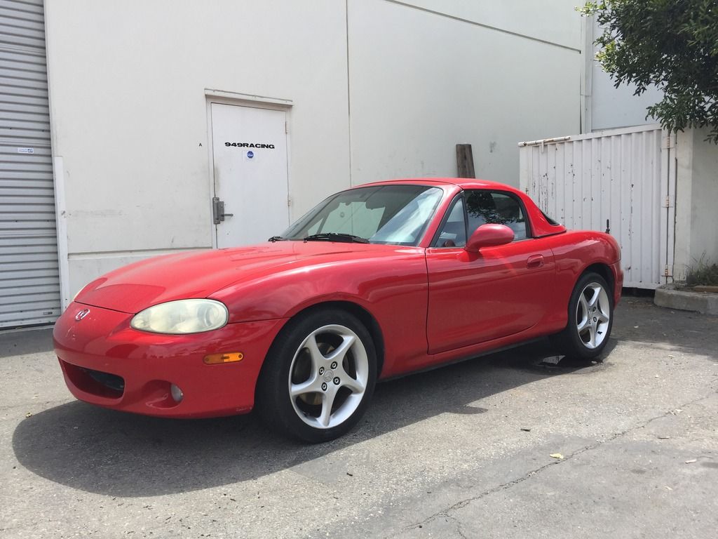

This thread will be the storage space for my 03 Club Sport side chick.
(Above photo taken after lots of cleaning and a professional paint correction)

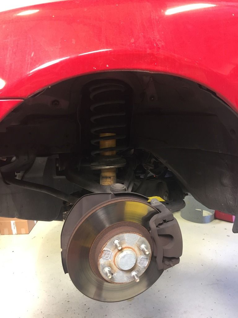

Current "don't look inside or under the hood" status on some 15x8 Beryllium 6ULs:

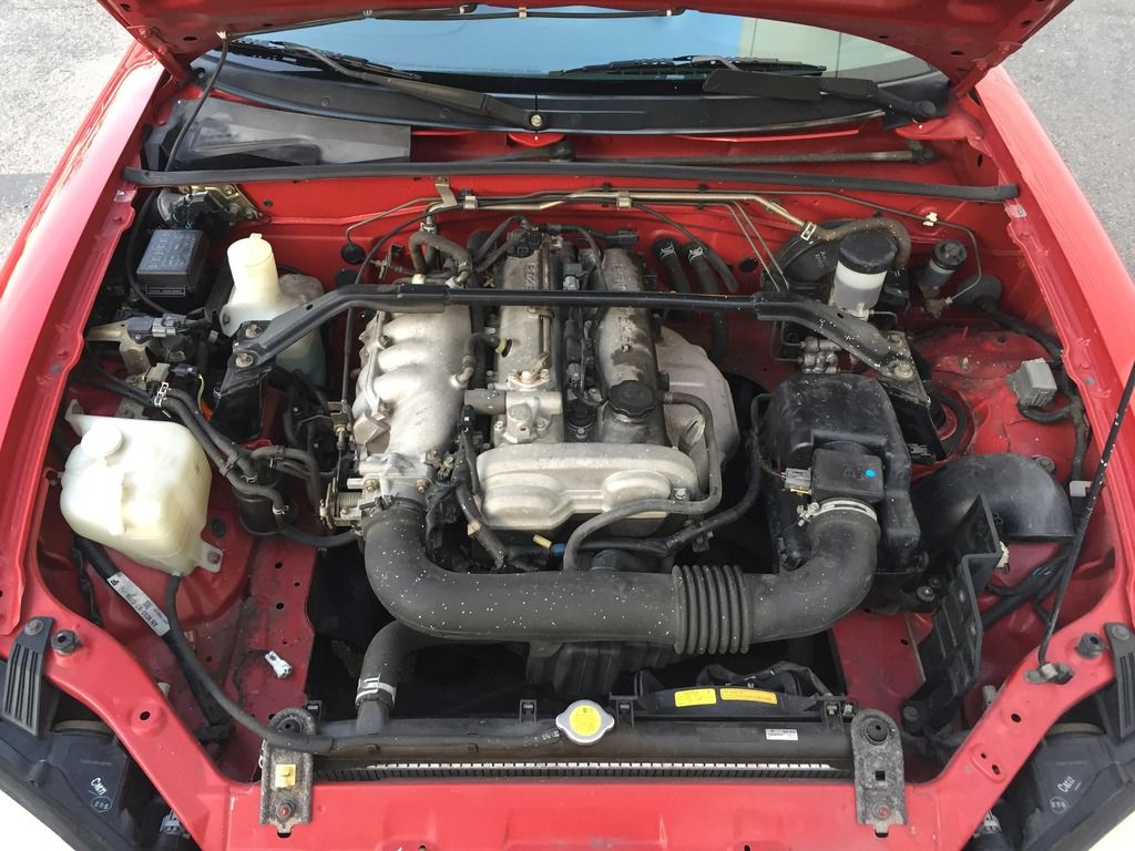

I've de-greased the bay, swapped all the fluids to Amsoil now, motor, trans and diff, treated the motor with some TriboTex nano oil treatment and finally killed the nagging CEL with a fresh CAS, plugs and wires. Whew. It is running exceptionally well. I am pretty sure the plugs and wires were OEM from 2003..
Amsoil Signature Series in the motor
Amsoil MTL in the trans
Amsoil Severe Gear in the diff
NGK iridium plugs BKR5EIX
NGK wires
