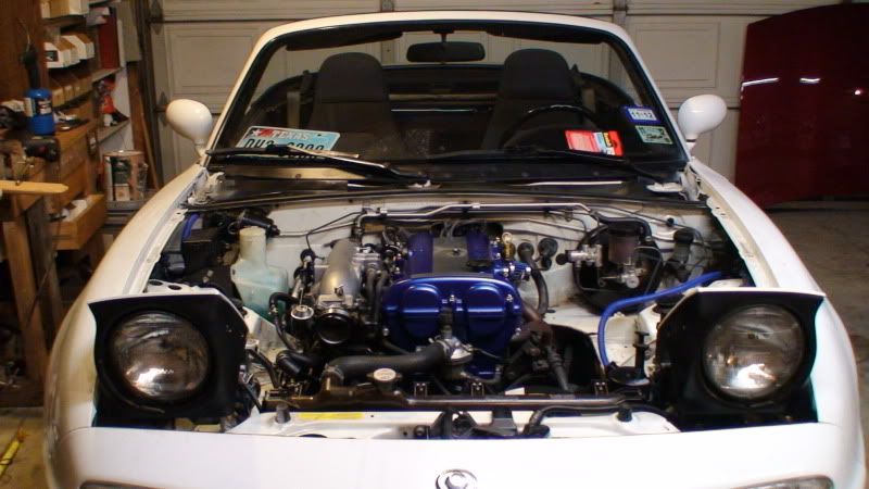

t25 Garrett turbo setup @5psi for now
slightly upgraded but still quiet exhaust

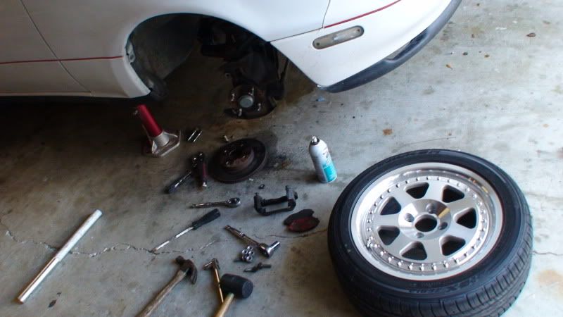

upgraded pads and rotors

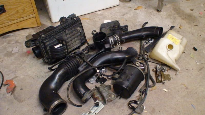

various engine bay deletes/tucks

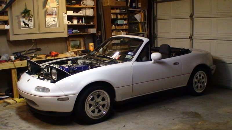

It's real fun to drive as a daily even at 5-6psi. When I get the urge for 18psi, I take the Z out for a drive.

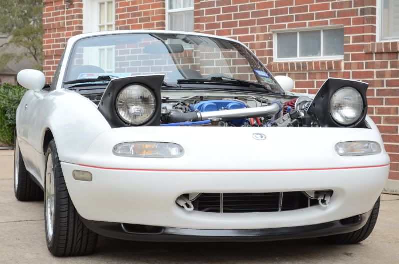

Of course I have a few more things I need to take care of, but this is how it sits now. I plan for a custom intercooler setup with proper positioning and ducting so that my cooling system is not rendered inefficient for my setup. I live in Houston so Summer isn't as forgiving as it is in other states. Upgraded radiator, coolant reroute, and fan mod are already being taken care of. Waiting on parts to come in is nerve racking.
Well, I'll do my best to keep this as updated as possible.

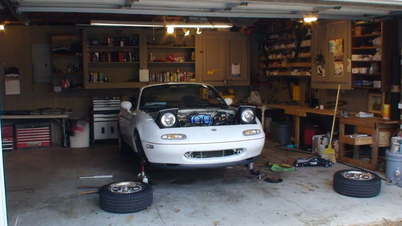

here are some current progress pictures for now
^current status
don't mind the pre coilover ride height
thank you for looking!

Built a better radiator overflow tank / catch can today.
Materials:
-stainless steel drinking bottle from Wal-Mart - 5$
-plastic T fitting
-vacuum hose
-rubber o ring (not necessary but it gave the T fitting a nicer fit.
I took the plastic cap off of the bottle and drilled a hole in the middle so that I could insert the bottom of the T fitting into it. You can use an O ring for a snugger fit if you feel like it.
Once the T fitting was in place, I attached a proper size piece of hose to it from the inner side of the cap.
Then I filled the new tank back up with water, screwed the modified cap back on, and attached the rubber drain hose I took off from the factory tank cap.
Last step was to attach the hose that comes from the radiator cap and secure the new tank/can. I put it behind the AC dryer/receiver and used SS fastening ties to hold it in place.
Works great and keeps the bay tidy. Not bad for a 5 dollar modification. I'm probably going to fit the factory overflow cap to make it look like it belongs more. I also ripped off the red pin stripping that came with the car and redid it in black.

Started working on a heat shield yesterday. Finished it up today, pretty much made it into an enclosure for the hot side of the turbo.
I'll update again when all my stuff comes in the mail.

After daily driving the car for some time, I'm really debating on whether or not I want to up the boost from 5psi. I know it's pretty low, but I'm not going to lie, I don't drive it that hard and never really felt the need for more power. I've just been using it as a fun little cruiser to take to college and other near by places. We'll see what happens after I fab up a new intercooler setup.

Installed the coilovers today. I love the way these look in the engine bay.
Front is full stiff
Rear is 3 clicks from full stiff
I'm probably going to go another 3/4 inch lower.
