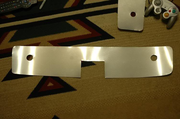

I made one out of dimpled aluminum that I found in the scrapbooking section of a craft store! It was in 12"X12" sheets so theres a joint line at the narrowest part, but it looks pretty sharp. I 3M taped it onto magnetic sheet and sprayed it with clearcoat since the quality of the metal was unknown. Its stood up to several coolant and oil spills during reg. maintenance.

cool beans, what did you use round the corners off? looks good!! Maybe you can make one for the wiper cowl area as well?

ohhh, not a bad idea lol. ill mess around with it tomorrow. i just used tin snips to round the corners... i slapped a penny up where the corner is and drew it on there and just tin snipped it. thanks for the comment.

It looks alot better mounted.

dammit i was thinking about doing that too but you posted it first..muahah how did you take off the air bag sensor? just bolt it off and it's done? or did you actually take off the whole wiring harness and everything?

That actually looks really good. I think I may attempt this as well, though I think I'll scuff mine up and paint it to match the rest of my engine bay.

yea man, nice easy project. i just used cardboard to make the template. i was gunna paint it, but i didn't have any paint i liked laying around.

did you see any difference in the temperature? or the actual heat of the engine when you pop the hood? i think imma do this..this comming friday..HEHE i have a bunch of sheet metal just waiting
