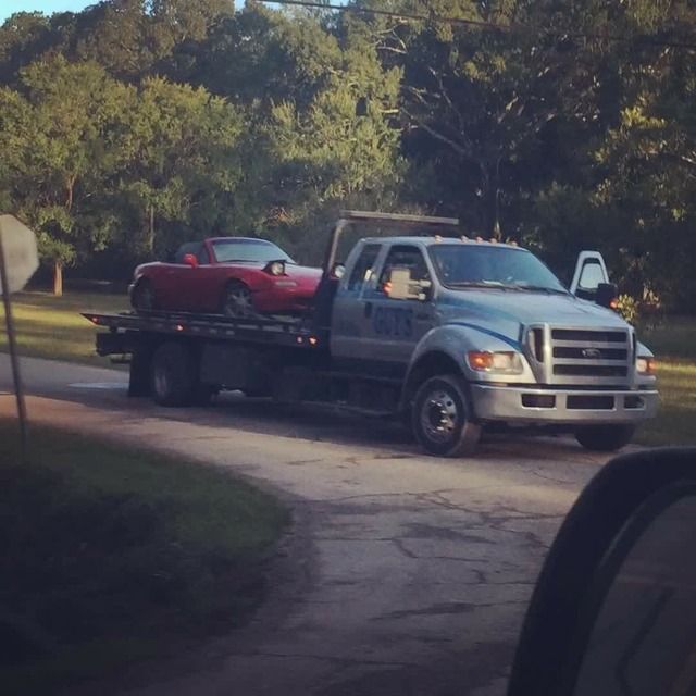

So I'm sure most everyone has seen the miata that went under in Said video.
Since this horrible flood is all too local for me I figured I could help out. So I put a Facebook status out asking if anyone knew the owners. Within about 5 min I was in touch with the owners. Come to find out the car was actually stolen and the woman driving was drunk.
The family lost everything including all their cars so I to me this is perfect for me to help.
Yesterday the car finally got to my house! So started getting into immediately.
The car is a 93 and I have a ECU and wiring harness ready. I have the local Mazda Dealer donating some little bits and I'm getting a good bit of maintenance stuff as well.
Gunna start with getting the interior out and getting as much mud out of the car as i can.
This is as my roommate found it heading into work monday.
