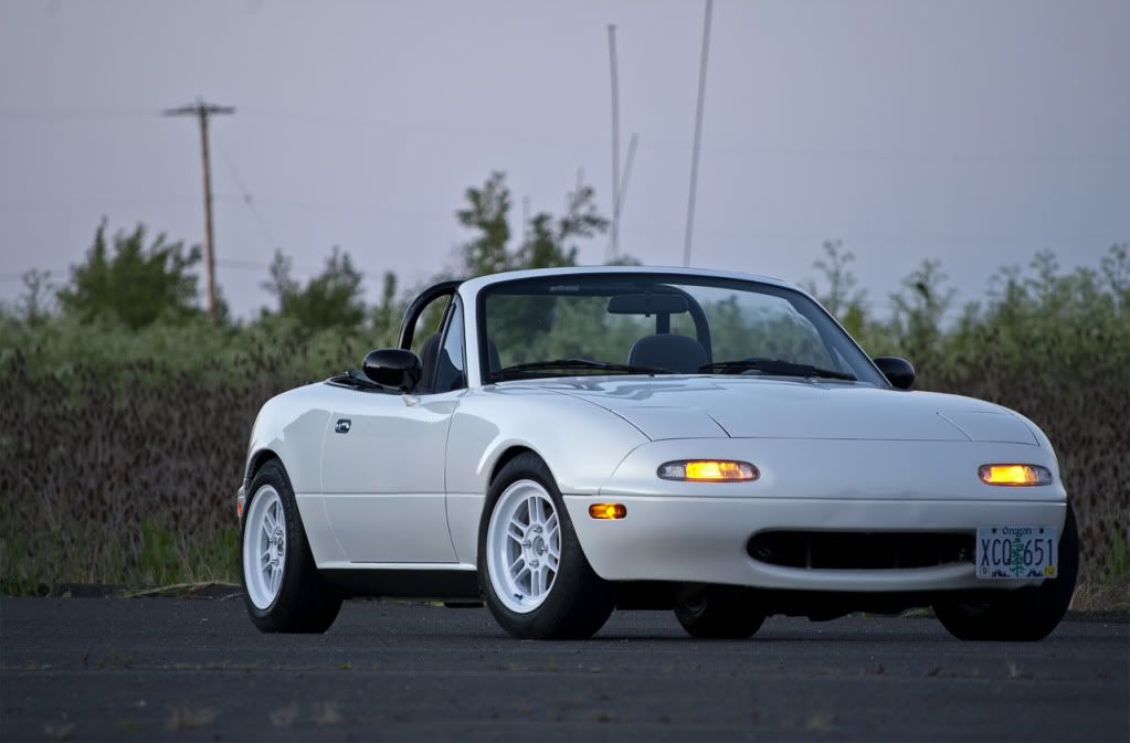

Back in February 2011, I was perusing craigslist for a daily driver. I was in too much of a hurry to buy car, a mistake I wont make again soon. I would have settled for some crapped out vw jetta; I'm glad I came across an add for a miata instead. I paid 2400 for an 89 NA with 178k on the ticker. I knew nothing about these cars.

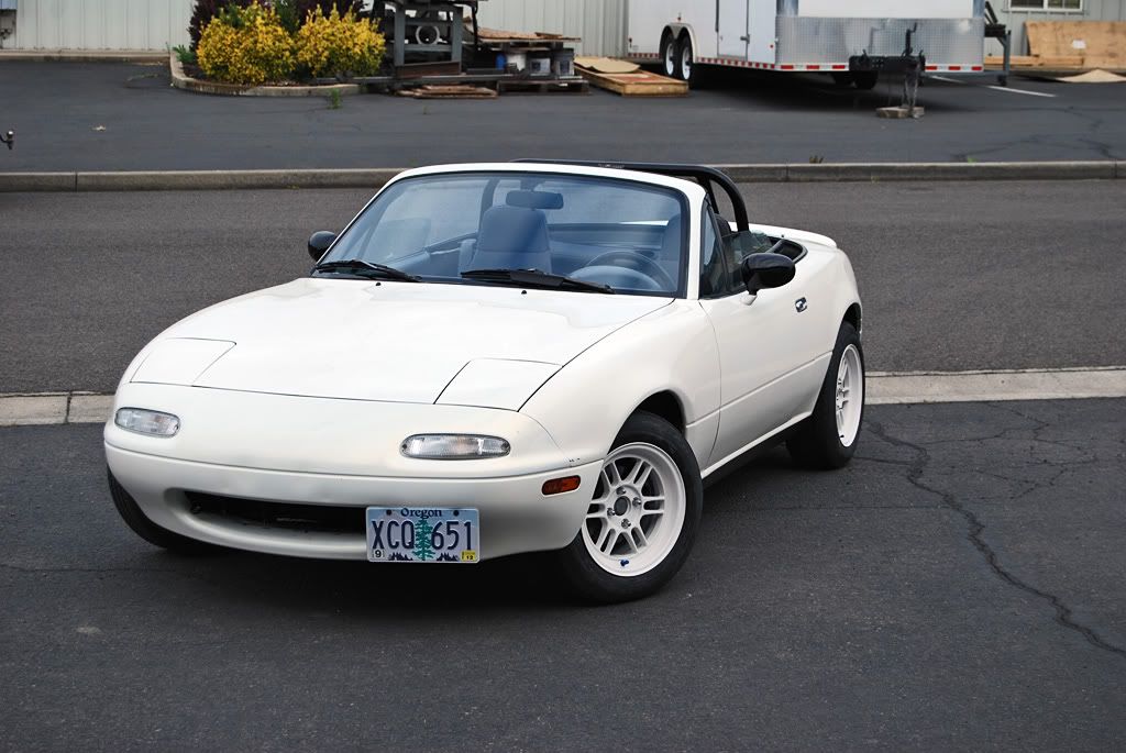

When I got it, it looked like this.
Overall not in bad shape. No rust and a mostly straight body. The factory red had been repainted (not very well) in a pearl white, which I have a love hate relationship with. Washing and waxing it the first time, I discovered where the paint had runs and blemishes. I decided quite early on that I would repaint it someday.

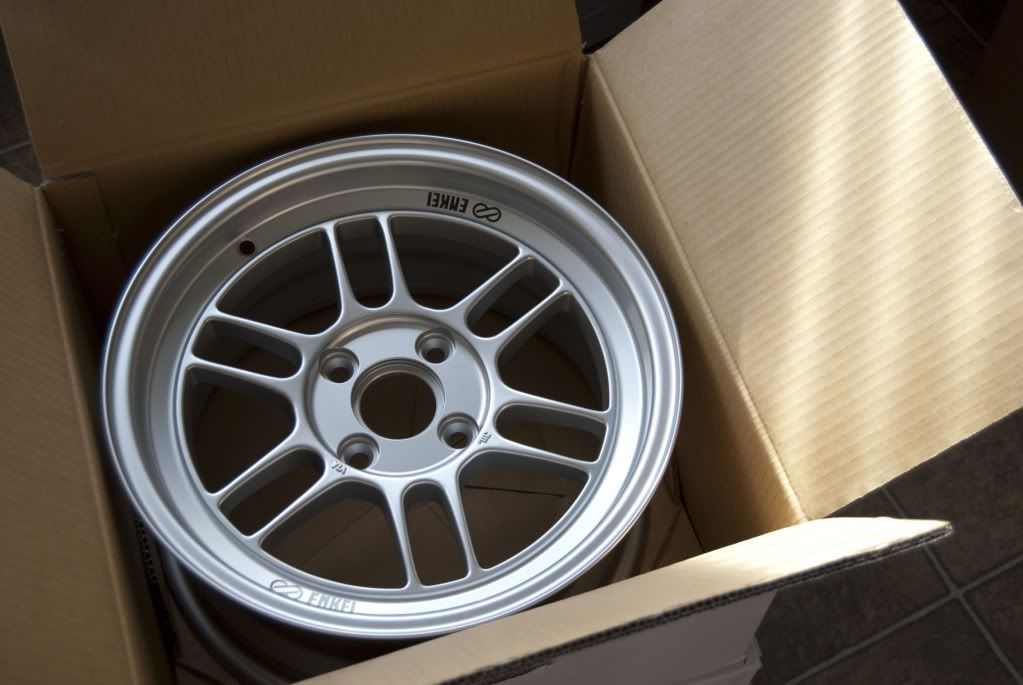

First to go had to be those terrible chromed daisies. Inspired by adam's sharka, I pulled the trigger on some 14x7 +28 RPF1's.

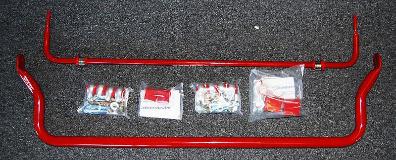

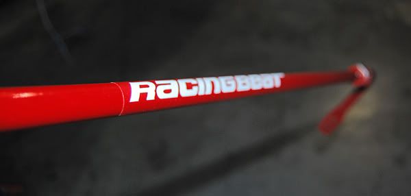

Not too soon after I decided I needed some racingbeat sways. Looking back now, I should have bought decent coilovers first, but live and learn I suppose.

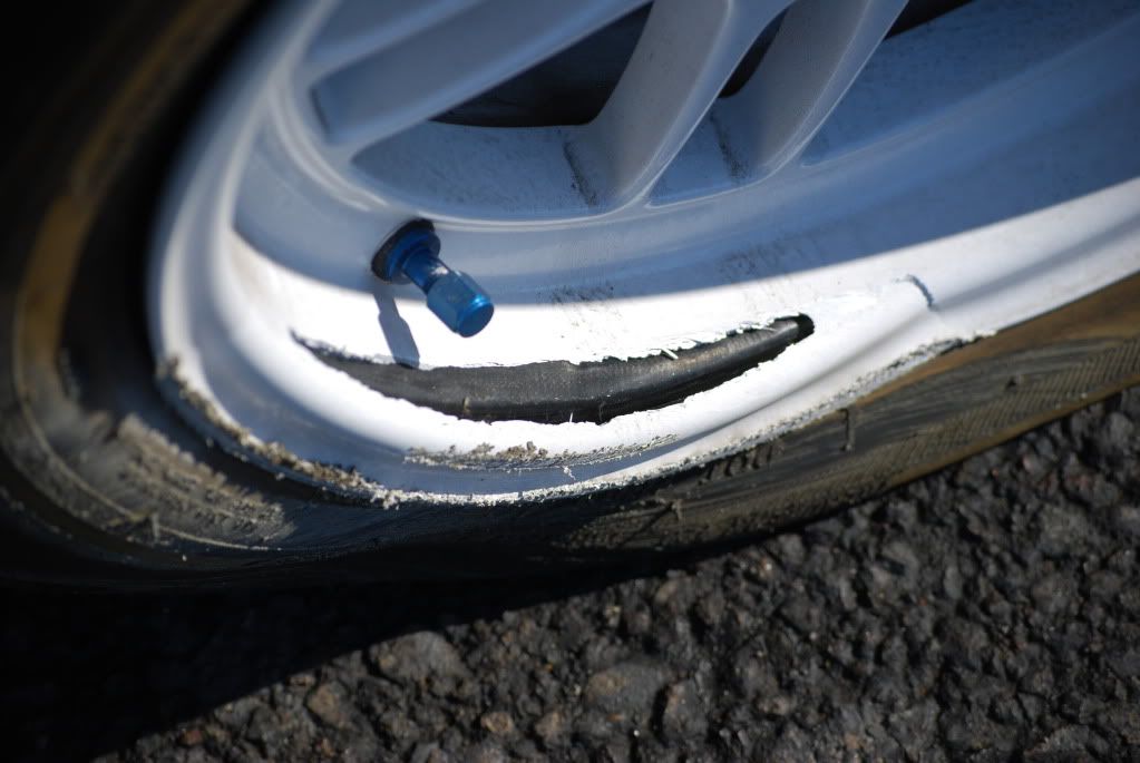

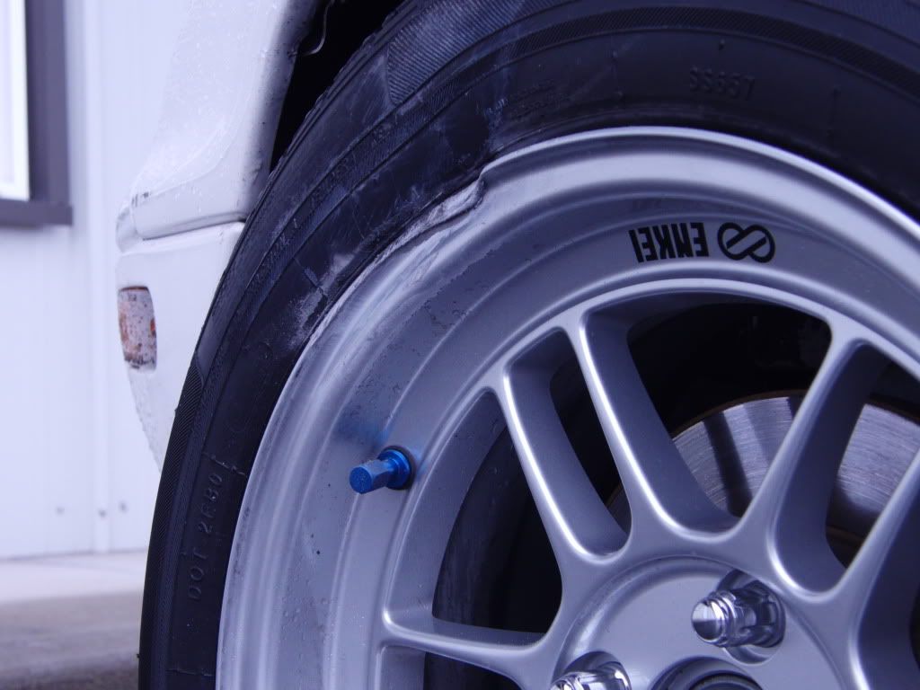

I guess its not a good drifting combo either. The boy racer in me couldnt handle the massive amount power under my right foot and I oversteered into a curb, in the wet, at the local highschool parking lot.

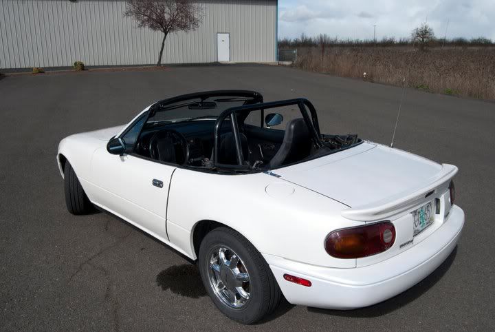

Bought another. Drained of cash, the next mod was some plastidip'd wheels. I wish I hadn't.
Photoshopped some low on. ^
Summer was fun in this car.
Next came some white surrounds. I wish I hadn't.

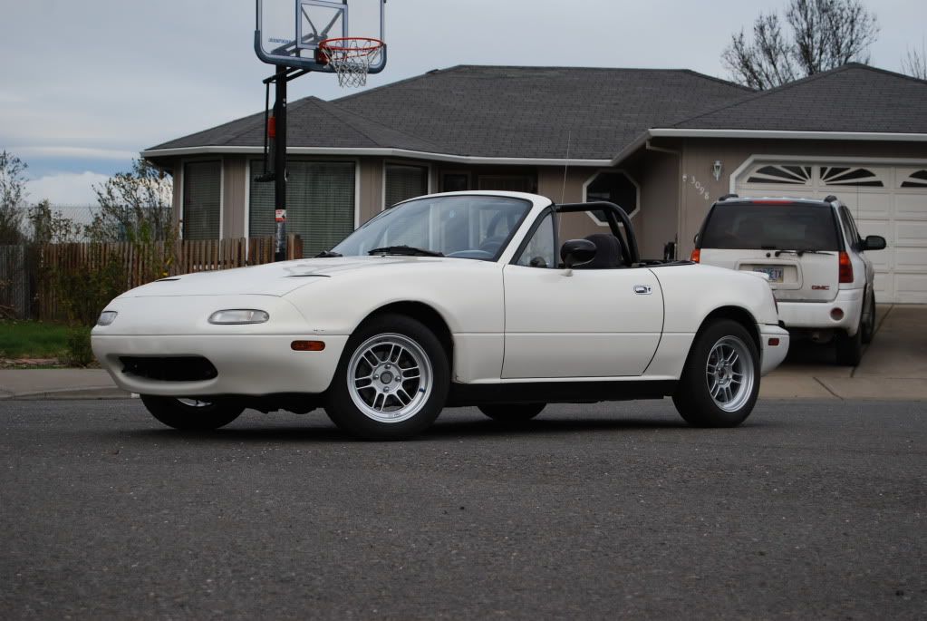

A month later, I decided I needed to indiscriminately waste some money, and decided to buy another RPF1.

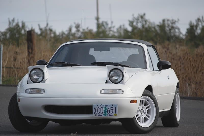

I had tired of the white headlight shrouds long enough. Time for some de-ricing.
Unscrewing...
I had plasti dipped the shrouds black before spraying a coat of rustoleum white on them. My thoughts were, ya the paint will peal right off once i get the plastidip started, not a chance. The only way is paint stripper or a heat gun. I didnt have paint stripper around and the heat gun was nearly warping the molded plastic. Wat ev, I'll just paint over the white.
I also decided to remove the angry eyes; I wasnt quite feeling them anymore.
My product of choice for this little project.
I was quite amazed at the result. Plastidip is amazing stuff. I've found it gives the nicest finish when applied in liberal coats. It dries to a nice satin finish, and if not painted over, is very easy to remove.
