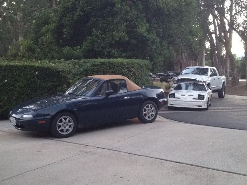

alright so as a few of you know, i finally got my miata the other day :D
(pic of said miata)
now..to ensure longevity of the otter, im going to be doing the following before modding ANYTHING..i want to have a good if not great jumping off point..feel me? haha
