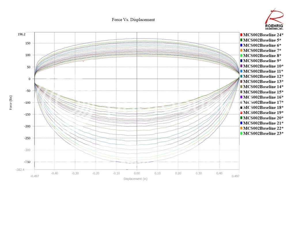

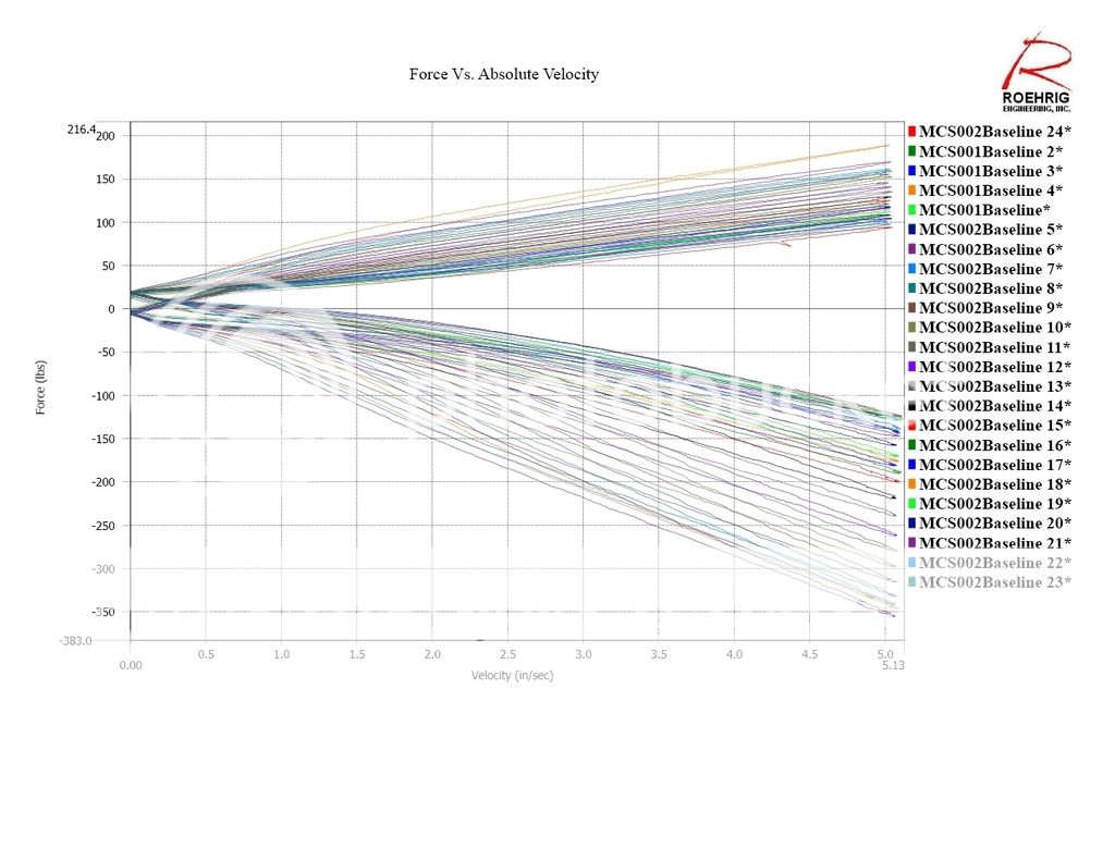

Here are some shock dynos performed on a set of singles by an independent party. Also shown for comparison are shock dynos from some Moton triples. These are undoctored unlike 99.9% of the shock dynos you see online. Notice the consistency of the MCS. I'll let the dynos speak for themselves but if you have questions just ask.
Force vs. Absolute Velocity. Multiple runs ok various dampening settings.
Force vs. Displacement

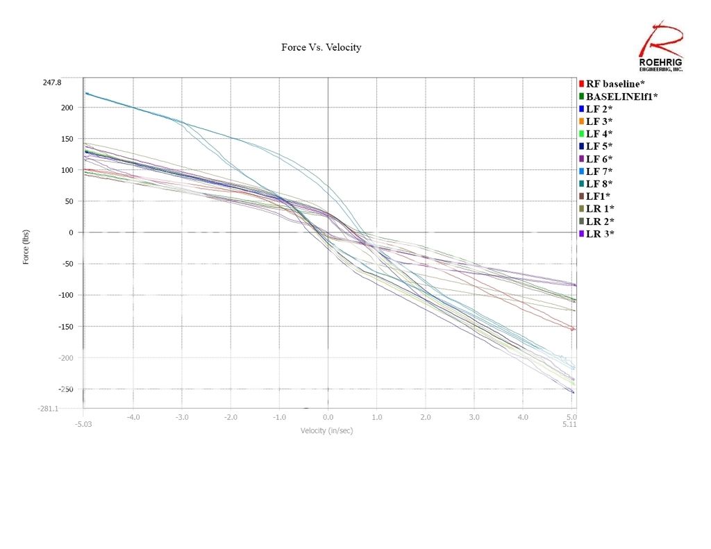

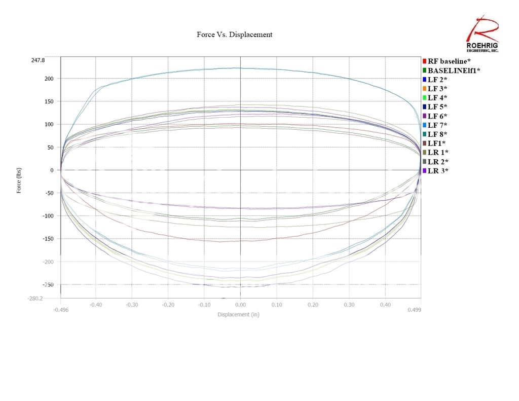

Now the motons for comparison
Force vs. velocity
