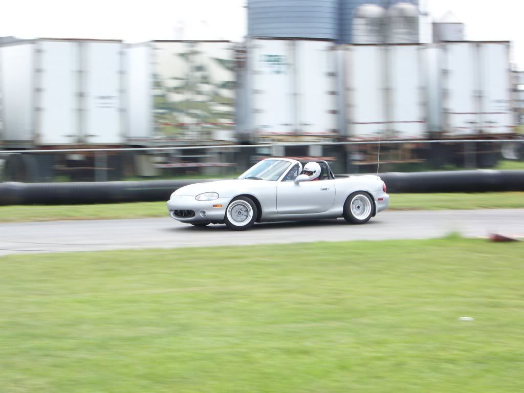

Got it on a sunday, I think, then ordered some BC coils from Chelsea @ Roadsterdrift, got a couple sets of XXR's, a harddog hardcore rollbar, a Bride Vios III, Nardi 330, upgraded the brakes; and pretty much left it like that for the rest of the year. Put all that in during the first week, then went to my first drift day in the miata that weekend.
I probably did about around 10 or so events last year, even got a small feature on Modified mag.
