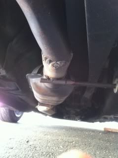

dont bash on me im a forum/car n000000b:cry:. so i bought a corksport catback exhaust couple days back, and when i looked under my car.. i realized my cat is welded to my stock exhaust.. my questions are:
1. can i use another bolt on stock miata cat and fit my corksport on that? i dont want to weld anything.. just bolt on everything.
2. will the holes of the stock miata cat and corksport exhaust line up?
3. will it pass emissions?
The first one on the grass is the corksport tip, the other 2 are my welded cat + stock exhaust
THANKS!

yes, the corksport exhaust is made to fit oem systems, and that normally consists of a bolt in cat. So any cat made for the miata will be bolt in. I suggest checking out the metalcore cats from Enthuza. They sound great, look great, bump your performance, and cost the same as a normal magnaflow ceramic cat.

Yes get an oem fitment cat. Enthuza, Magnaflow etc.. make direct fit options.
and is enthuza carb legal? i live in cali.. most cats ive found are 49 state legal. is that one included with cali legal?
Rehabilitation Officer
8,110 Posts
If it is not, it should be noted in the website. Just call them and ask. One guy runs the business and he's a good dude.
Not sure how strict cali is, but I've never had a problem. I believe they are just normal 200 cell metalcore cats. They have ceramic ones too for $50 bucks less if you wanna go the cheap route.
158 Posts
Discussion Starter #7
oh okay! and i had another question.. should i get a 2.25? or a 2.5 inch.. if my corksport is 2.5 inches, it'd make sense to get a 2.5 cat? or 2.25
