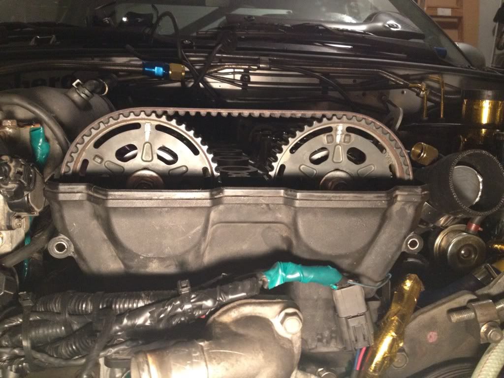

I checked the timing belt, and it seems to be fine:

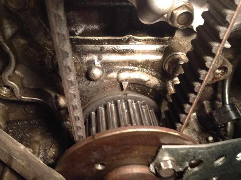

I haven't changed the crank yet, however I repositioned it, just incase. I don't think there is anything wrong with the crank sensor, since I never messed with it before.
