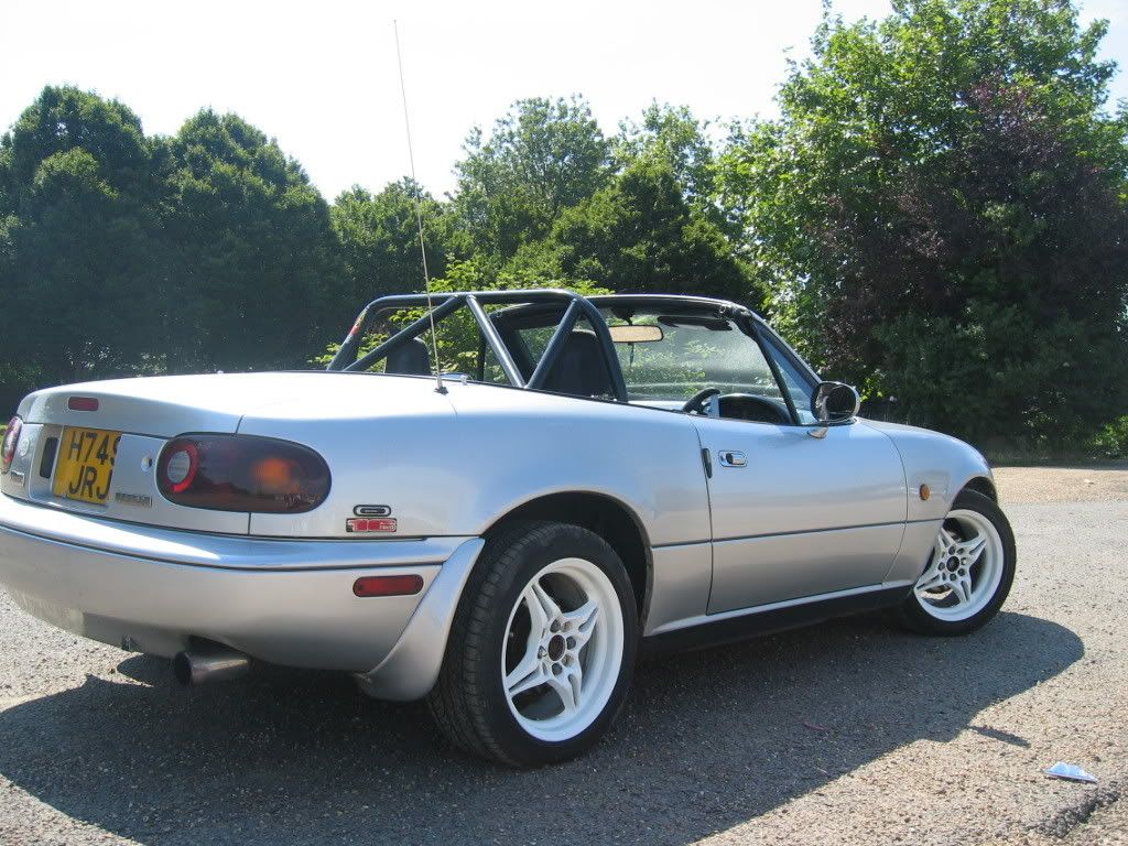

I've got NB KYB AGX shocks with NB FM Springs & NB top mounts on my NA and the car seems to have the monster truck look about it
Front measures 12.25"
rear measures 14.25"
is there anything I can do to get the car lower and is cutting the springs a worthwhile option.

The suspension has been on the car nearly a year now so it should have settled by now I would have thought - I bought the set up from this car - apologies for the quality, but the ride height should be obvious from the pic - There must be something I can do to level things out or is there a fundemental difference between NB/NA suspension set up

NB Top hats all round - The car drives fine and corners very flat, I just can't feeling that it should be lower especially at the back.

I took some pics this afternoon - If I'm honest the car handles very well in its current set up and I'm not sure the $550 investment in ground control coilovers would be money well spent simply to lower the rear of the car.
