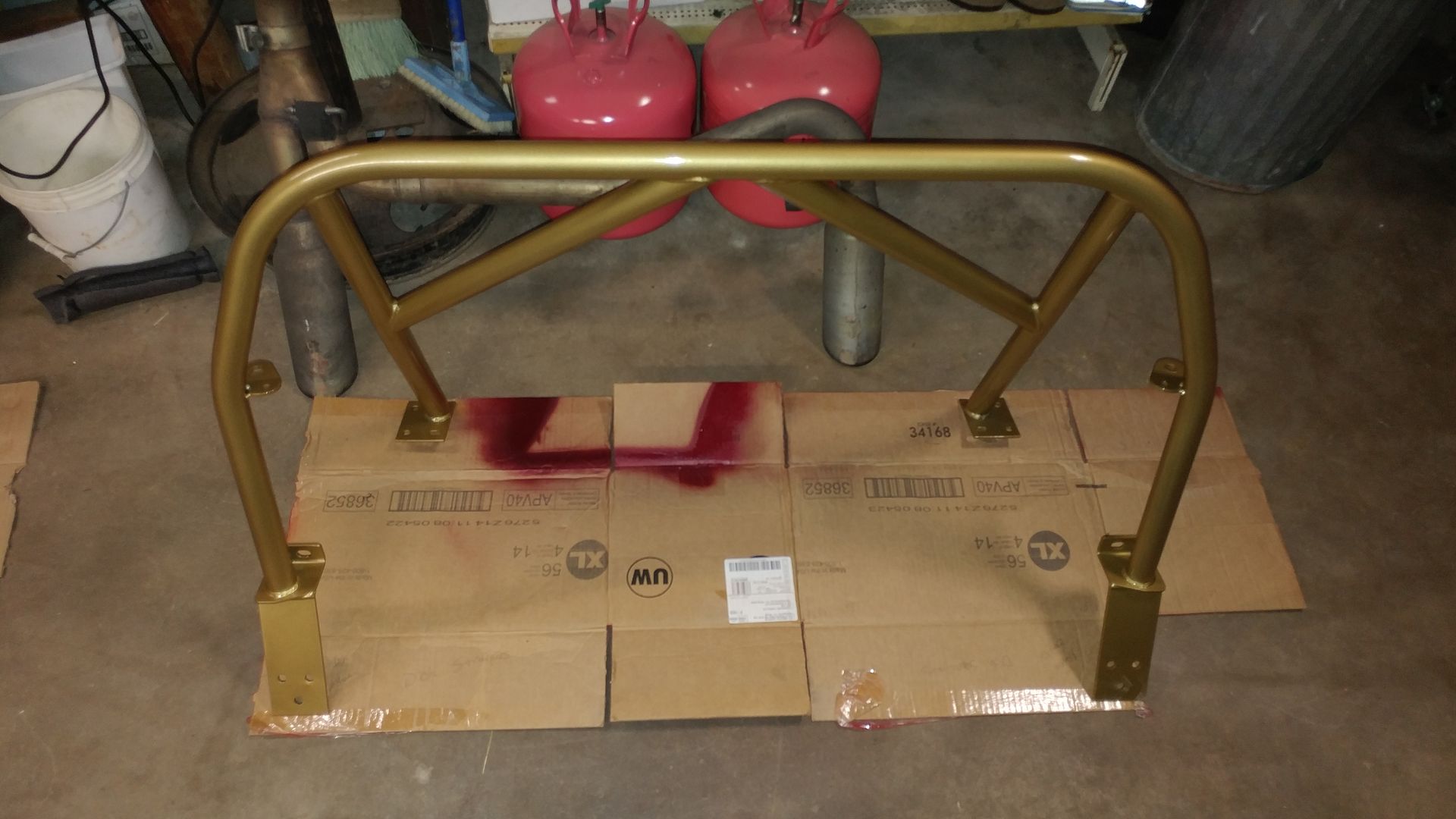

I haven't been on this forum in forever.
Sorry about that.
I didn't go with a Boss Frog after all, the local custom shop made a creazy expensive offer, so I got a TR-Lane roll bar.
Getting that thing approved for road-use was an odyssey (TR-Lane roll bars don't come with German-language paperwork, surprising to no one).
I eventually got it approved, so now I'm using the TR-Lane Single Diagonal, covered in appropriate padding from Pleie Motorsport (since my head is literally right next to it).
Had to reroute some wires and create a new chassis ground, plus machine some spacers for the main bars (the roll bar is about 10mm too narrow).
The soft-top closes fine, but one seam leaves an imprint in the padding.
The bar doesn't obstruct the rearview mirror, and with the TÜV's permission I left a gap at the top of the padding to mount a GoPro (upside down).
