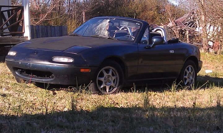

Obviously the first thing I need is a miata
That'll do nicely...

Now I need a plan................
Ok I'll make it handle and leave the engine alone.
The people I know that do well run a big bar up front and none out back.....
Suspension Techniques sells a 25mm on eBay cheap I think I'll do that.
Shocks..... Shocks..... So many choices so little money... I'll have to come back to that.
Tires... I'm thinking direzzas in 185/60/14 for now and rs3s later when I can afford to buy 15's
Stay tuned for more autocross nonsense
