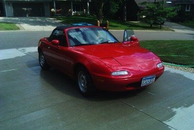

So here she is the day I bought her:

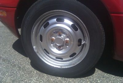

First thing to do was get rid of these:

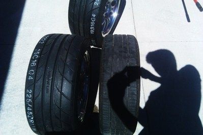

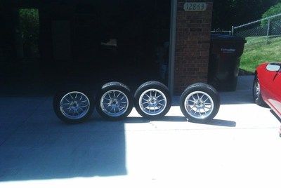

And replacing them with these: 15" 6uls wrapped in Hankook RS3's... what else.
I'd say they should lay down some grip a little better:

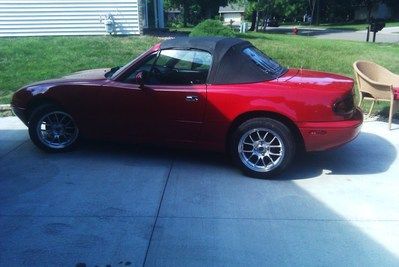

And on they went:

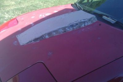

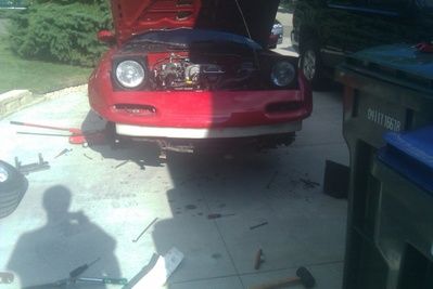

So while waiting for the suspension and some other goodies in the mail, I got to work on the hood scoop...
And the bumper: took it off and chopped the bottom part off for some customization.
I then created a template for the bottom section of the bumper:
Glassed it and connected it to the upper part: also did so filling of the scoop.
(note that the black on the bumper is just some plasti-dip in testing of grill shapes)
