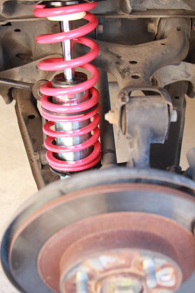

hey guys, does anyone have this problem with their riceland?

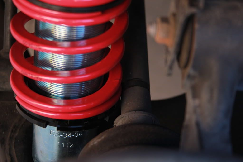

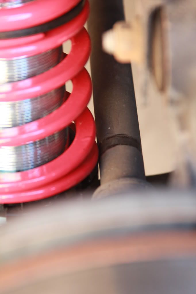

the rear coils i set it to the lowest with helper springs oon and seems like there isnt any clearance between the coilover and the drive axle, and this is what happen....
got any idea to fix this guys, any help would be greatly appreciated

You can take the helper spring out and raise the collars up so it's still the same height and the spring wouldn't be as close to the axle

I found my racelands rubbed and made contact on my NA6 but my NA8 they cleared... not sure if the 1.8 has slightly more clearance.
could remove helper springs and raise collars or just let it rub till it clears haha
1,755 Posts
Once the helper is out you can put the car on the ground and not worry about rubbing. And no, you more than likely won't have a problem when jacking the car up.

Helper spring is on the wrong side. I had mine as low as they would go and they didn't rub.
shoot i didnt realize two side are different for the helper spring, thanks for the info
this was the only way i can think of, but then i have to work with the measurement to get the right height

lol this is a NA8, and i wouldnt want it to rub till it clears, its pretty dangerous, i guess i just put it in wrong like what MiataRacer says, i really hope it helps once i switch back....

You will rub no matter what if you go low . I had my helpers removed and still rubbed , I installed stance rears an they rub. Its the size of the bottom mount on the coilovers that will cause the problem if you go low .By the looks of your height if you remove the helpers and raise the perch you shouldn't have a problem .

I had this when I went reasonably low on Racelands.. But on my NB. Raised it up just enough to clear the driveshaft. Still low enough, but not slammed.

I removed the helpers and had no problem. I have my perches all the way up now, no helper springs and the fender sits "flush" with the top if the tire and dont have to worry about any helper spring rubbage

Shouldn't be too hard to get the ride height. The helper spring is fully compressed when the car is sitting so measure the helper spring fully compressed and raise the collar that much.

Mine did that too. I just dealt with it until the axle flattened one side of the collars until it didn't rub any more.
