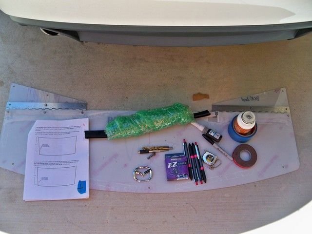

every thing needed for install:
How the aluminum brackets go(there was no clear pic online or in the instructions):

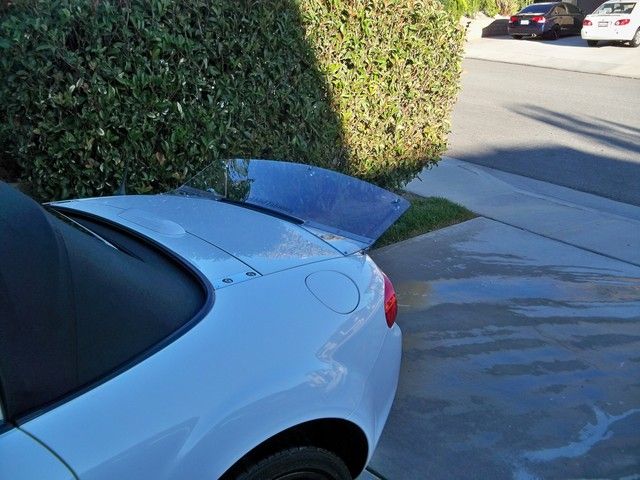

all installed:
Low angle:
High angle:

Customer Service 10/10 Moti was amazing to deal with, in the good kind of way. Called when I had a question & he answered or returned the call/text & explained as best he could over the phone, still had an issue I couldn't figure out with spoiler bowing towards the center drove it down to the shop, he took a few minutes looking at it and figured things out rather quickly, he really knows his products...in my case I had tightened the hardware on the braces before attaching to the car & I needed to properly drill the 4 inner supporting holes & the hole saw spots underneath on the triangular pieces which Moti did for me
Install difficulty 4/10 plan on it taking a couple hours...read instructions first, blue tape(maybe double/triple layer it to protect the paint from the hinged areas), measure & mark, re-measure, re-measure again if it still looks good go for the drill otherwise re-measure again, absolutely have a buddy for help(this is what I believe caused my misalignment issue causing my inner 4 holes to be oblonged at the end result(completely my fault). if you're at all hesitant about install and local to the shop, check with Moti on availability/cost of that he really moves quickly
Looks: 7/10 I like it, it's not everyone's cup of tea especially for a daily driver with the 3 support rods. I'm contemplating painting the lexan to match the car. It's not as pretty as others but, for the price, really can't be beat, only way possible is if you were an engineer or very connected with the right people/tooling, When I looked into my own semi-similar design cost got to around $150 but I knew it wouldn't look as nice or be as effective plus figuring out where to drill for my own design would've ended up with my nicely painted trunk looking like swiss cheese
Functionality 10/10 it actually really works well....it doesn't significantly unbalance the car but the ass is very planted. I don't have quantifiable data but it's a very noticeable difference from nothing to lowest angle, then lowest angle to highest angle is another jump.
Went out for a test drive after installing it with the lowest angle(rods fully shortened) didn't notice any increase in drag though I'm sure there may be some at this level but going through a long sweeper style on ramp and then through a short windy road car didn't get unsettled like it had been due to crappy pavement, even at lower speeds of 30-40 it was noticeable
Then the same run after adjusting the rods to create the steepest angle, wow. I'm sure this setup utilizes drag to make the downforce but with it fully raised the rear really feels very planted, almost to the point of unbalance and needing front aero or suspension improvements but it doesn't make it tail happy just a very noticeable effect of hey rear is really down & front not so much
Pricepoint 8/10: It's not cheap but, it works very well and is designed about as perfect as a single plane spoiler can be. Sure as mentioned above you could make your own cheaper, will it look as nice? doubtful, will it be as effective? again, doubtful is it as effective as a 1k APR GTC200, no, does it have more drag sure but, price vs. effectiveness if someone could get quantifiable numbers( $ vs. DF, $ vs. drag & downforce lbs vs drag caused) i'm pretty sure the BBFW would run reasonably competivily against the APR
Install hints:
Mentioned in the instructions but....ANTI-SEIZE ALL THE THINGS! I didn't heed this warning & had to take an angle grinder to a bolt on the little aluminum bracket :smile9: luckily it worked well, didn't screw up the bracket, a quick trip to the hardware store and all was well again
blue tape is your friend
straightedge will need to be at least 4 feet long & a buddy for that step of marking/drilling the inner 4 holes is a very good idea
leave all support rod hardware loose until final install
Ideas for improvement/options for consideration:
-label bracket sides, although only takes a few minutes to quickly figure out if switched between sides or update instructions to include their specific orientation....more squared part towards bottom, sides face outward
-templates for drilling in addition to the measurement instructions would be great

Pictures are finally up :)
