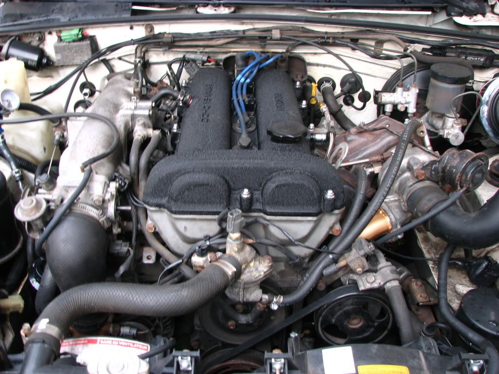

Thought I should do an introduction. I have been on the forum for quite some time now browsing the for sale section and such. I am a proud owner of a 1990 crystal white NA with 84k on the clock. I purchased the car last December and have since then in this order installed megasquirt I, a 1.8 clutch with 6 puck disc, and a full td05 14b turbo setup currently pushing 9 p.s.i. which I pieced together for < $500. The car runs so good that I ended up selling the Mazdaspeed protege which I owned for almost 5 years as it was not as fun as the miata. Heres some pictures, let me know what you guys think.

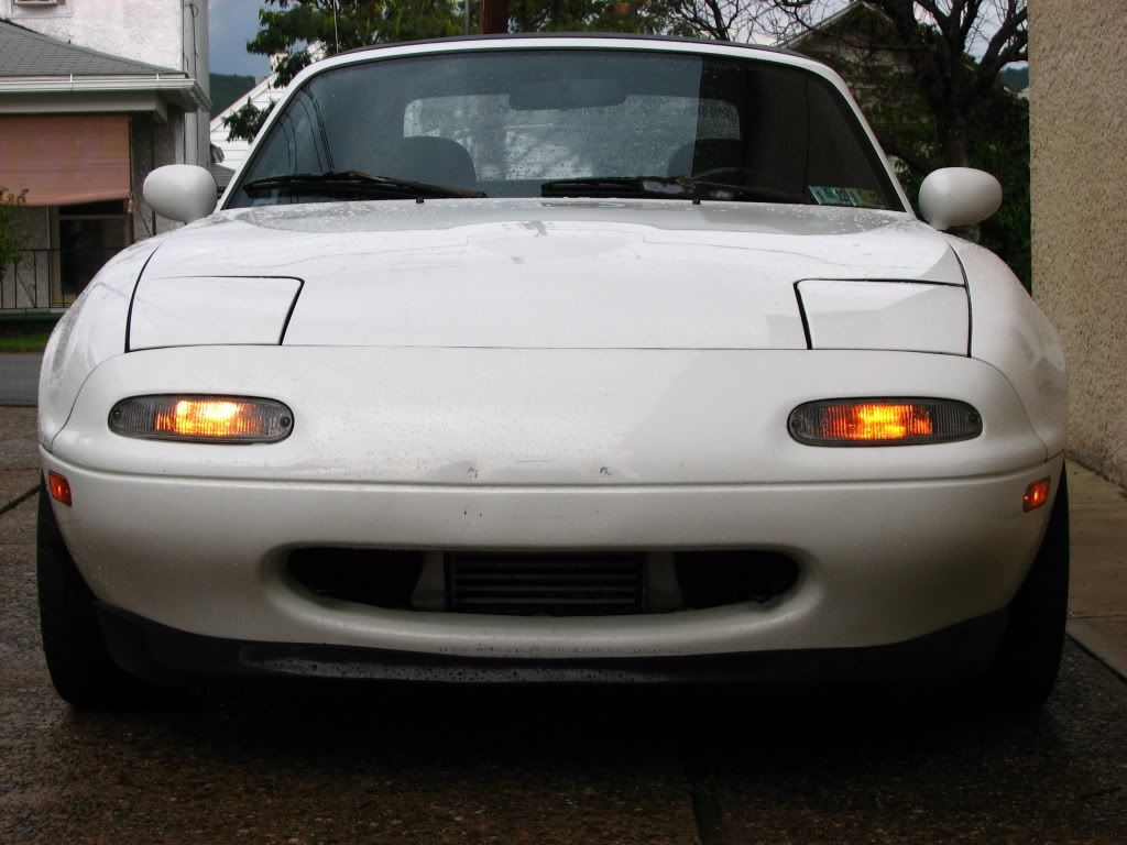

I have a genuine mitsubishi td05 14b pushing 9psi right now. Using the OBX manifold and downpipe (I know they are junk.) I'm wating for the manifold to crack so I can have a better one made, but its held up so far. I constructed an adjustable preload brace for it which seems to be keeping it in one piece. I found the intercooler from another user on CR, which I assume is also Ebay. Intercooler piping and couplers were pieced together using 2.25" piping I found off a turbo Volvo, and Saab which I found in the local pull it yard. I had a local friend who also has a miata weld the intercooler piping together with his Tig Welder. He does excellent work with custom fabrication and would recommend him to anyone local as he is very reasonable with cost. Megasquirt I v3.0 from DIYAutotune soldered together myself. Stock Exhaust for now, I'm Going to build an exhaust in the spring. I believe that is everything.
