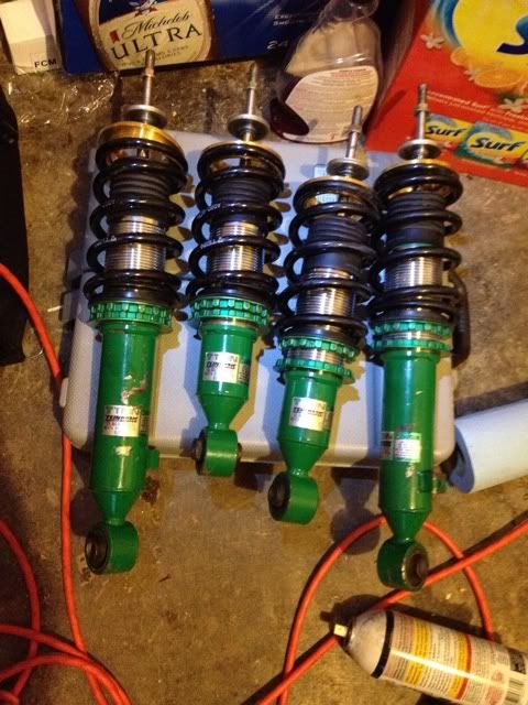

I bought used Tein Basics recently and the bumpstops are ripped and in bad shape. I've been looking around at different options and I notice alot of people talk about FCM bumpstops. the Tein bumpstops are 40mm, is there any specific size FCM bumpstop I should get? They have a 36mm and a 46mm. I am going to be using my stock NA tophats. I tried finding direct Tein bumpstop replacements but can't seem to find any.
Here's a picture of my suspension:
Thanks for any help

Go smaller if possible. There's not a lot of travel there to begin with. You can also trim the Tein stops if you get a hold of a set.

I'd of personally gone with the 46mm. The bumpstop is soft enough that it will just act like a stiffer damper. These coils could use more dampening. They ride pretty harsh for their lower spring rates in comparison to other coilovers.
