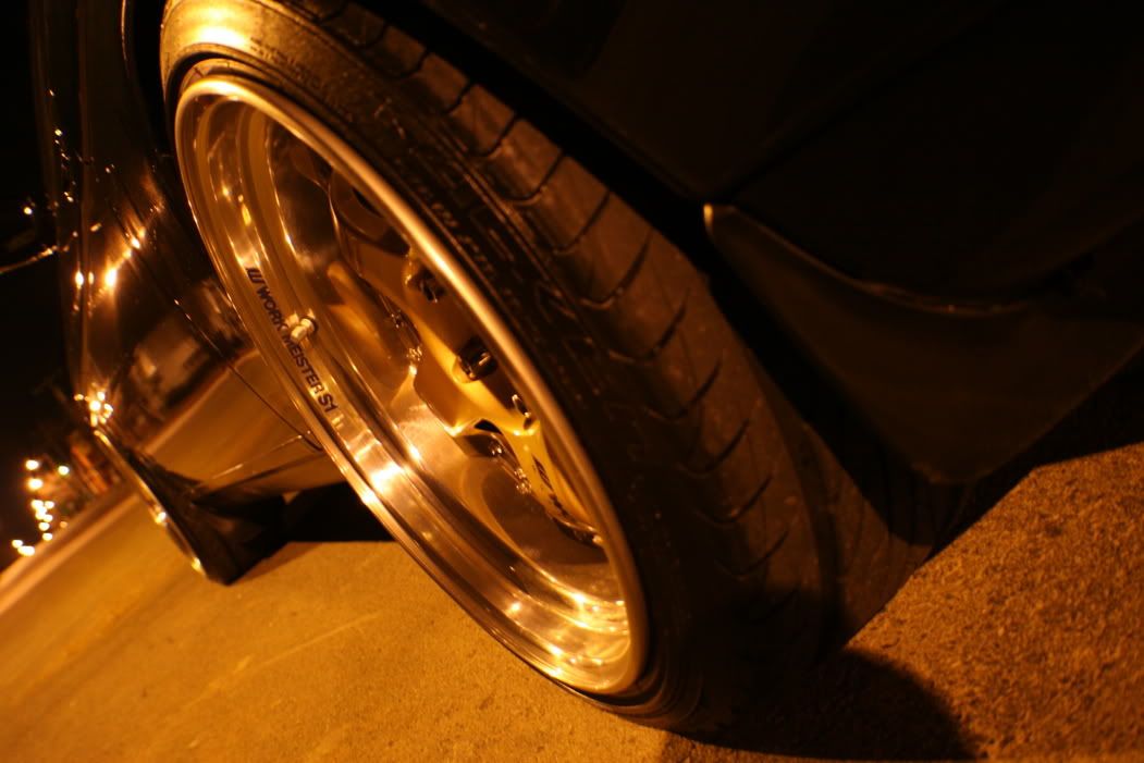

Here some pix of my other cars I owned...I have been a huge fan of aggressive offsets and fitment
my Rhd twin turbo toyota soarer
My q45
my buddies GS300
